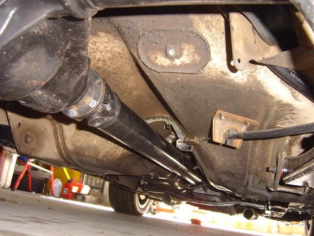

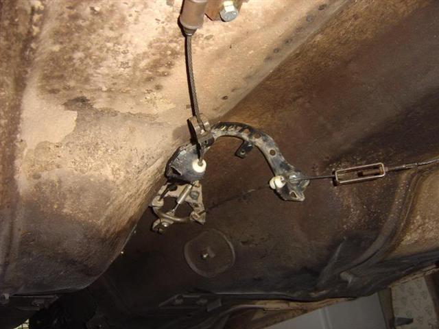

Here are a couple of pics that I have borrowed from around the place that should give you some ideas on what other have done.
I don't see how the cables could interfere with the leaf springs though.
Cheers
Matt

Postby Mk2RS+R32 » Sat May 05, 2012 2:57 pm
I think I like this setup.
It's more direct and less twist and turns. I'm not sure how close it'll get to the exhaust though. This way you can use most of the R31 brackets.
What are you doing for the brake line routing to/from the axle and car under body? To complicate, after moving the fuel tank, I'm going to run the exhaust down the one side, which is also where the brake line runs. I'm thinking the exhaust may get in the way of this routing to/from the axle and car under body.
Here's whats happening at the moment with the exhaust crossing over at present. As you can see the flex line may get in the way of the exhaust. Although maybe I could shield it??
