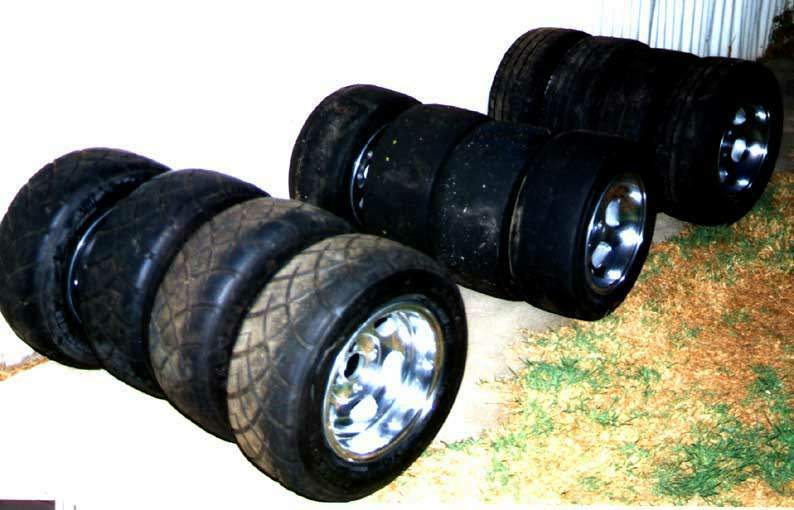

Couple o sets of wheels. 2 sets of 13 x 7 old A008rs on one,
A032s on other and a set 13 x 7/8 with F2/3 slicks on them, a s they become available.
