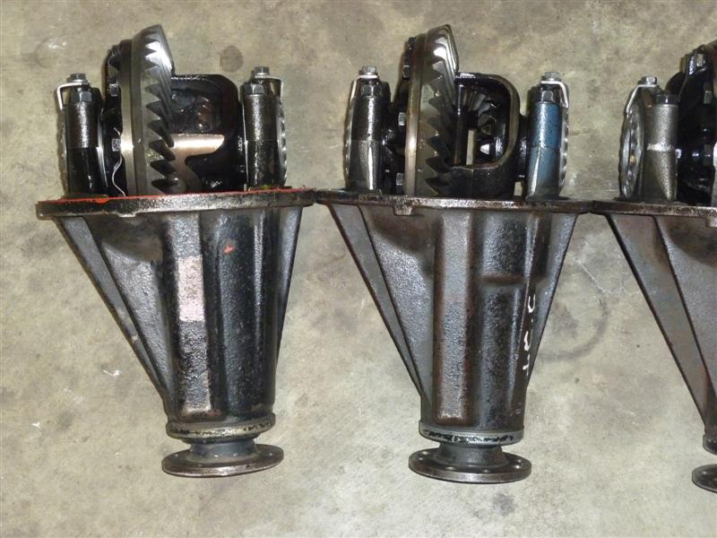

OK so I had a look and here is the difference. On the left is a 4.8 middle is 3.5 and right is 4.3. Second pic shows a later center on the left that is a different housing again.
P1030514 (Medium).JPG (65.6 KiB) Viewed 16342 times
P1030517 (Medium).JPG (87.05 KiB) Viewed 16342 times
