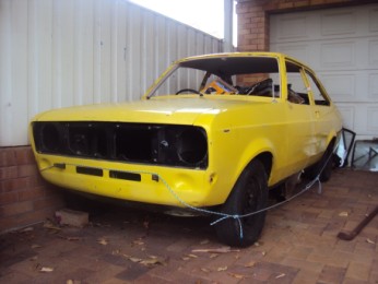

Postby stevedesertmartin » Sun Nov 20, 2011 11:53 am
Few pics. Top 1 is lately in the garage. Others were when it was collecting dust.
