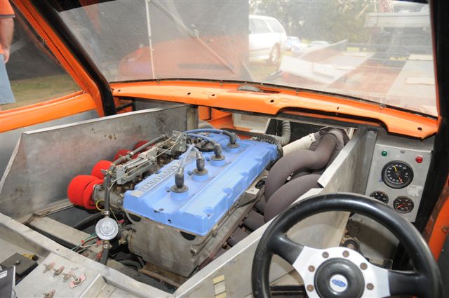

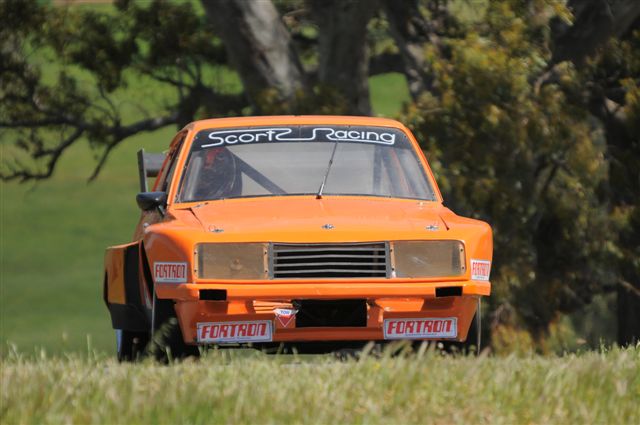

Built by Wayne Poulden, Adelaide. First log booked 1980 with Lotus Twin Cam. Then sold on and converted to SOHC Pinto. Purchased the car as a rolling chassis 1992. With a rocket box/4.1 diff and 16" wheels it had some issues but was brilliant to drive. Only a lack of quality slicks stopped it from being really competitive. Killed the Pinto at 1994 Aust hillclimb title.
Car has sat in the shed from lack of funding for extended periods but eventually built a N/A Cosworth engine.This engine was built on a limited budget back in the late 90's and it took me years to get it to the hillclimb in any competitive state. At the time with the exchange rates and budget that I had, a reliable low power/ good torque engine with standard driveline would give me most fun/$$$$ ratio. Engine developed 95KW on 48mm Dellortos. The car weighs 910kg with me in it so it went well. Don't think it was ever going to be class winner but it would have been fun driving the wheels off it. Gremlins were chasing me in 2010 however. Ignition troubles and then head gasket problems resulted in the engine being removed and stripped. It was obvious when the head came off that a lack of compression was the main issue. New Accralite short height pistons and Farndon long rods were chosen and a Pinto block sourced and prepared. YB head which I believe is an ex Carter RS500 head had been ported on the inlets but the exhausts left virtually untouched Bench flowing showed ok flows on the inlet(226cfm@.500") but the exhaust maxing out at 156cfm@.300". More porting needed. Biggest issue is the head has been skimmed to 137.2mm so the combustion chambers are going to need work also. Onwards
Mid Mounted N/A YB Cosworth

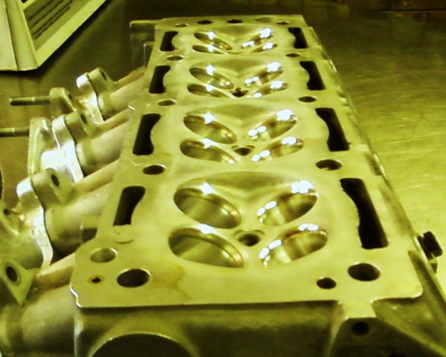

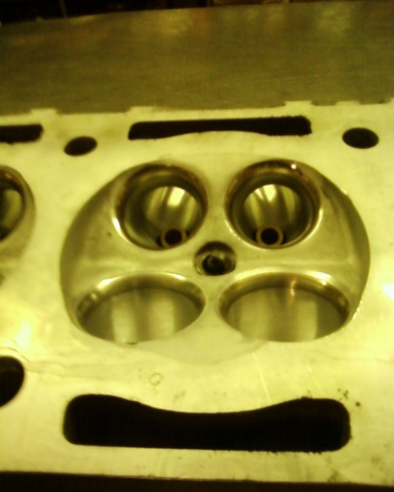

Head is still having porting work done. Quite a few deliveries from the UK have come in in the last month. Valve springs, steel retainers, solid followers and a very nice alloy sump. Also a new cam belt/tensioner bearing and distributor cap. Other than a new oil pump everything is in place for the bottom end. I need to get flow figures for the head then talk to Tighes about camshafts. I took pictures of the ports and seats then left my camera at home so cant post any pics just now. Home next week so I'll put some pics up then.
Update 21-3-2011 Head has been ported and bench flowed to 250HP @ .450" lift. Started at 233HP then went back to 200 with the inlet manifold added and with further porting is at the 250HP. Exhaust ports have yet to be touched but will probably only get a light taping and matching to the exhaust manifold.
Photo0077 (600 x 480).jpg (44.2 KiB) Viewed 34323 times
Porting finished. Bench flow figure 250HP @ .450" lift. Ordered camshafts from Tighe's in Brisbane. They should be delivered in Adelaide just in time for the Easter break. Next step is to finish valve stems and set up the followers and shims(which according to Danny M can be "fiddly") Then it's dummy build time.....

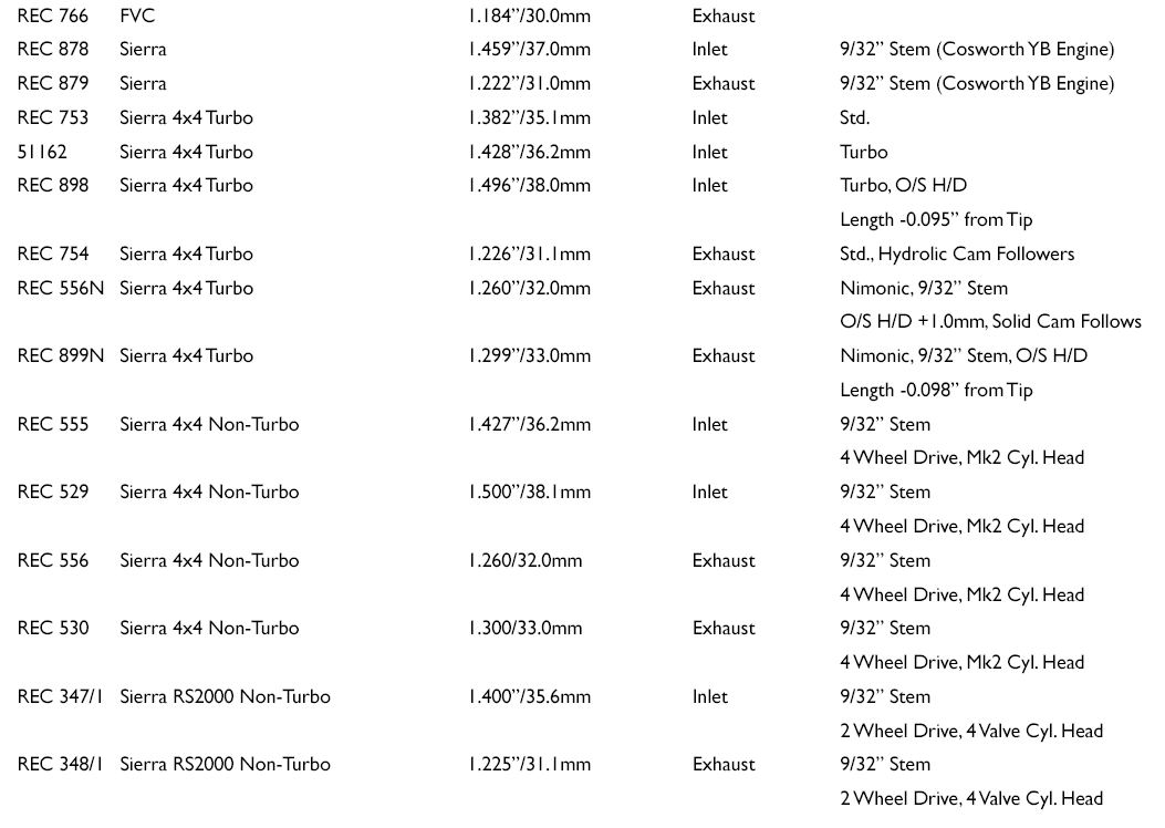

My custom long stem valves with 37mm inlets and 32mm exhausts are now standard length. Somehow this has been made my fault!!!!!!!!! What part of; "I'm having trouble sourcing long stem valves with 37mm heads. Can you make some from blanks? Sure Steve, we do it all the time, no worries." are you having trouble with. List price for G & S Valves 37mm/31mm UK17.00 ea off the shelf. My so called custom valves which are now not what I wanted will be double that at least. Not effin happy at the moment.

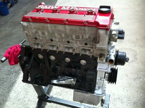

Cylinder head is finished. Tighe camshafts installed and shimmed. I now have every component ready to go for the dummy build other than a largish wad of cash. Just need to get the Annual holiday in August out of the way.
Hygienically sealed for my protection
Photo0105 (512 x 640).jpg (55.92 KiB) Viewed 33708 times
Cleaning the block for painting
Photo0104 (511 x 295).jpg (41.68 KiB) Viewed 33708 times

The REC valves 878 and 879 were what I looked at originally. Talking directly to Paul Ivey in England the cost of getting this size valve in long stem was expensive to say the least. As I said, list price for the standard length valve was 17 quid each plus freight or about $475 AUD. Valves as machined and fitted( includes 2 x inlet, 2 x exhaust made for porting, plus the other 12, machining collett grooves and polishing plus freight to exchange followers for central pillar type) for a grand total of $1137.
Will they be of the same quality as Ferrea or G&S remains to be seen. From what I've seen and heard the springs are the more critical component in these heads so lets hope the REC gold springs are up for the job. For an 8500RPM engine i hope they're good.
