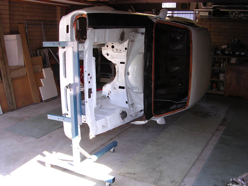

And last weekend I took the front of the shell of the rotisserie and peeled the Mk1's face off.
