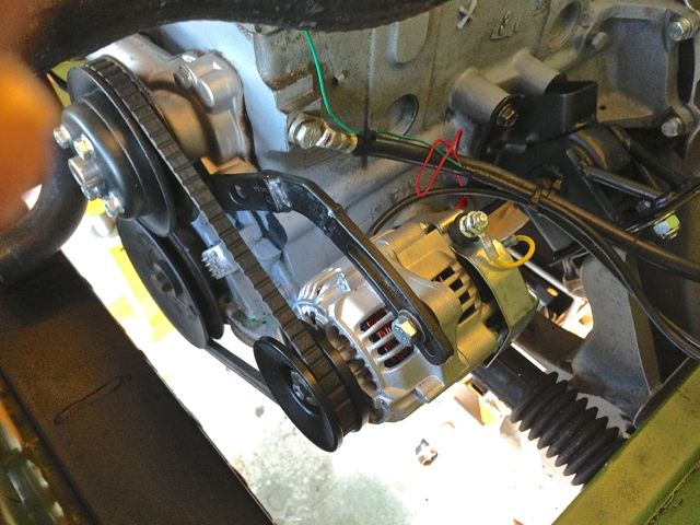

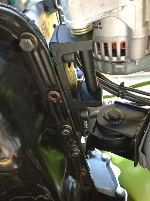

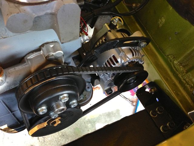

Quick update, Noosa Hillclimb is in 2 weeks time, still a couple of things to finish off with the car. The clutch has been cleaned up and is back in. The oil leak from the rear extension to casing seal in the t5 has been fixed and it's back in the car too. Driveline angles are back to normal with the help of the new engine mounts so i hope that's taken care of the vibration that was coming through. The new alternator is in, only had to slightly modify the bottom bracket and weld a bit into the top bracket. Also got a slightly shorter fanbelt to make it fit a bit better.

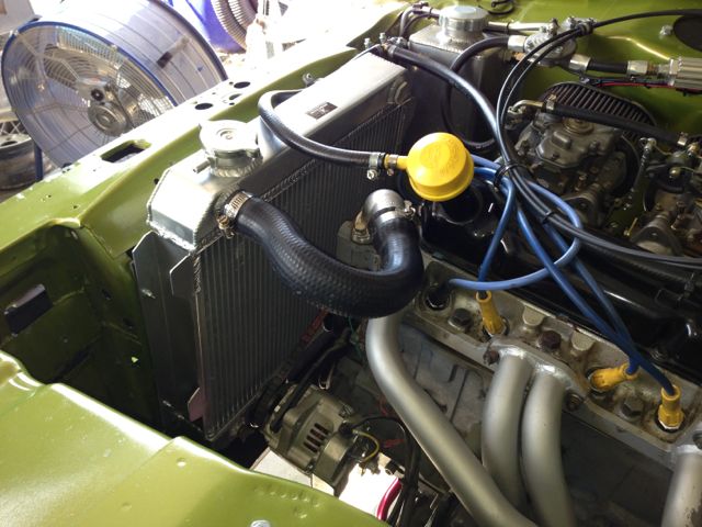

I bought an electric fan today so I need to come up with some brackets to mount that too. Once that's done and the carbies are back on it'll be ready to go again! Morgan Park 2 weeks after Noosa so hopefully there's nothing major to do inbetween them.

I've got a new alloy radiator ready to go in this weekend, special, looks OK, we'll see how it goes.

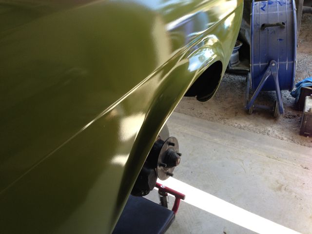

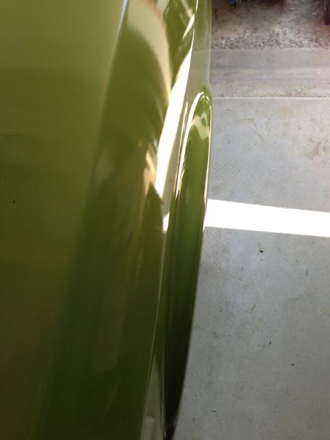

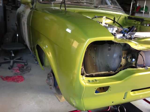

Hi Greg, they're Mk2 Escort 'eyebrows' welded in place. Because the mk2's had 13" wheels, they are much better shaped at the front (as well as wider) for when you've got a lot of extra caster.
Sofar, it seems to have worked well. I mostly run 175/60s on 7" rims which just fit under the standard guards. This will hopefully let me run 215/50s or at least run some alloy hubs (which add about 10mm). They sit about 5mm higher at the top of the arch than the originals, but nowhere near as high as twin cam ones. I'll get some pics when its back on the ground later in the week.
New radiator in and ready to go. Should work a touch better than the original 1300 one!
