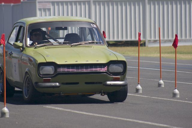

HSCCQ Khanacross, Willowbank. What a blast! 4th outright overall and would have had an outright fastest time on one of the tests if I hadn't taken a couple of poles with me!

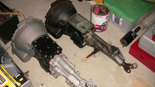

Some more bits arrived recently for the next upgrade which is fitting the 5 speed. I've got an alloy bellhousing and a new starter to be installed along with some electricals reshuffling to be done to relocate the shifter. Next event is the HRCC Autumn event at the end of April - better get to the shed...i mean garage...

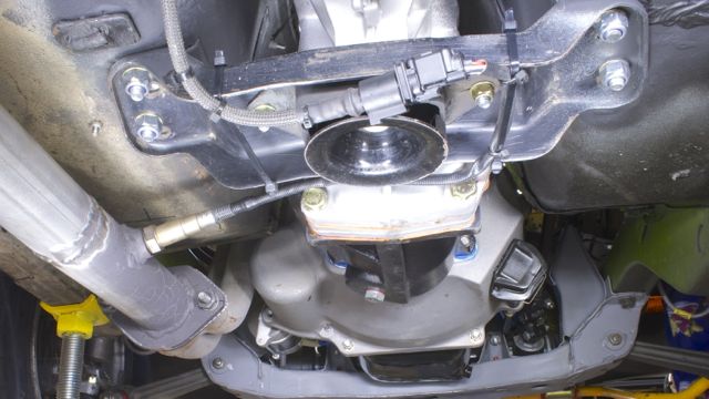

OK, we're off to Morgan Park this weekend for HRCCQ's Autumn Historic races and regularities. The green machine now has it's legs back with the addition of a new 5-speed T9 (2.9:1 1st gear option). With an alloy bellhousing and gear reduction starter it's only 2kg's heavier than the old setup. Luckily I've had the last couple of weeks off work so everything's been done without needing any midnight finishes too It's also got a new pair of Bilstein's on the back and i've added a window net too.
Currently at Morgan Park for the HRCC Autumn Historics. One practice and one competitive event finished successfully, 3.7 seconds better than my previous best here
Back from a successful Morgan Park event last weekend. I managed a pb of 1:33.9 (3.0km circuit) on Sunday morning which was 4 seconds faster than my best in July last year, the 5.1 LSD and 5 speed gearbox as well as a new set of Bilsteins on the back really made a huge difference! Only a couple of minor issues were raised, by the end of 8 or so hard laps it was getting a bit hot so a better radiator will be required. The alternator appears to be on its last legs so I'll be looking to rebuild it or to get a new one, also need to find a bigger pulley for it to slow it down a bit.
The new 5 speed performed flawlessly and shifts really, really well. Due to mounting the gearbox crossmember directly on the floor, the engine is angled back a bit too much so I had to wedge a couple of washers under the front of the spring saddles to bring the nose of the diff up a bit. Plan for the long-term wishlist is a world cup style crossmember which will enable me to drop the front of the motor a bit and i'll look at spacing up the gearbox mount as well.

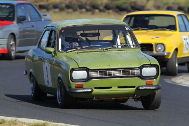

20130427 hrcc 1 1821s.jpg (44.4 KiB) Viewed 30290 times
20130427 hrcc 2 1746s.jpg (44.73 KiB) Viewed 30290 times
20130427 hrcc 1 726s.jpg (49.9 KiB) Viewed 30290 times
Fantastic drop in lap time Scott. Always good to see money spent giving results. I'll be doing the July Historic's. Keen to see if the recent changes can improve my time from the Qld sprint event from October last year, I've got to got to better 1.26.872. The regularity team event sounds interesting where can I read about this. See you at the July event should be plenty of cars for us to pass. Darrin
Thanks Darrin, I can't see any more huge drops in lap time in the near future! I'm planning on doing the July historics also. We need to get the groups split up in time order, although it is nice to do a bit of overtaking, it absolutely screws the lap times!

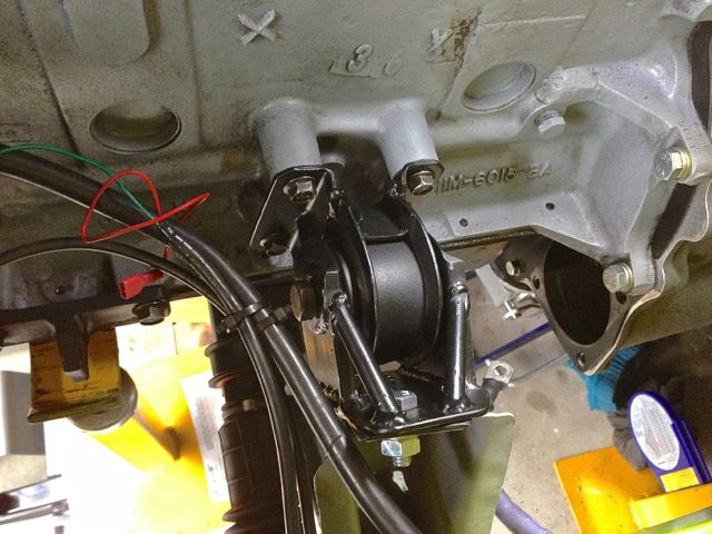

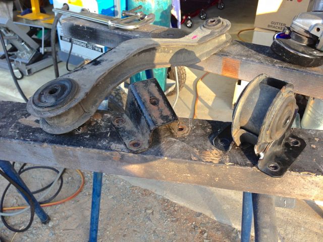

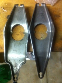

Next event is MG's Noosa Hillclimb on the 29th/30th of June and there's a few things to do to the car before then. Aforementioned clutch needs to be sorted, looks like grease is coming out of the spigot bearing so it'll need a good clean and possibly a new clutch plate. I've also made a new set of engine mounts so that I can get the driveline angles back to normal, there's been a bit of a vibration since i put the 5 speed in it.
Engine mounts are a combination of EB Falcon diff upper control arms and standard engine mounts, similar to what I ran on a rally car a few years ago.

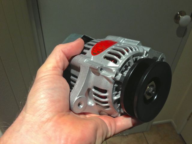

Also, the alternator is shagged so a new one is in order. I'll need to come up with a bracket of sorts for it, shouldn't be too hard.
Hi Matt, alternator is a Denso 'size', I got it through Summit Racing (along with a bunch of other stuff) I looked at it last night, should be pretty simple to make a mount for it.
