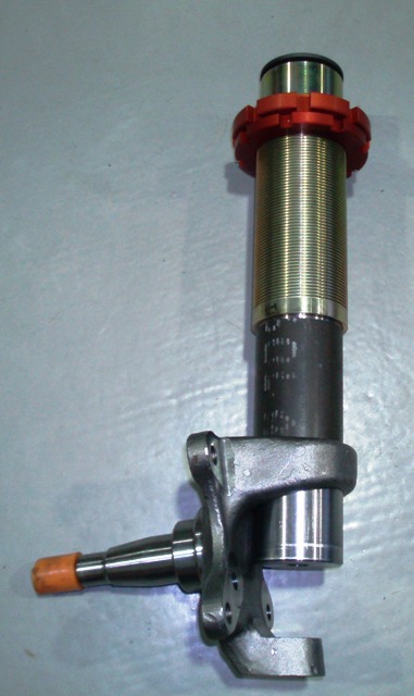

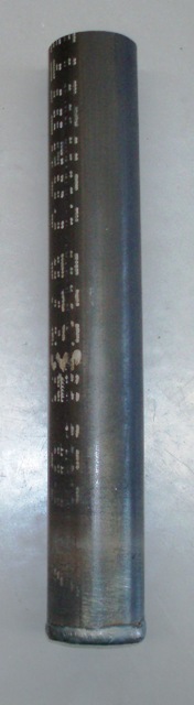

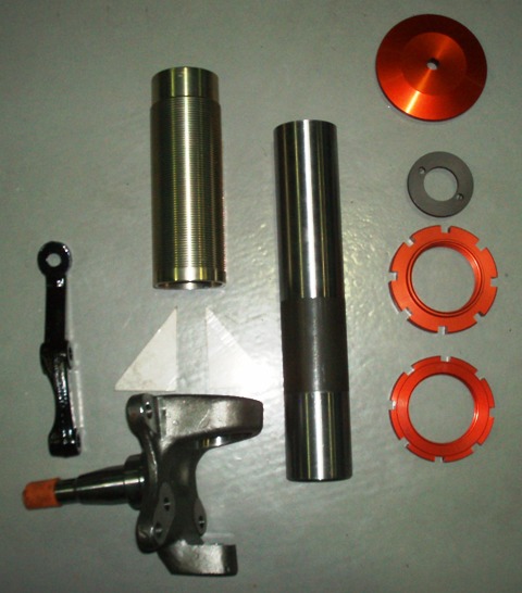

Postby Paul T » Wed Jul 16, 2014 8:21 am
I build up struts from scratch.
2" CDS .080" wall.
The rest needs to be sorted based on insert and set up.
If using second hand stub axles it's best to jig them and machine out what's left of the old tube after cutting it down.

Postby jpayne » Wed Jul 16, 2014 9:43 am
Thanks Paul,
exactly what I was after.
