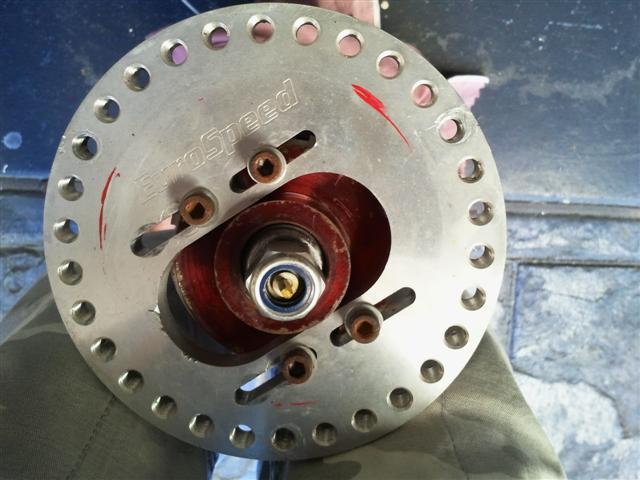

Postby Matt1975 » Sun Sep 09, 2012 4:14 pm
Look like GRP4 to me.
I have the Eurospeed ones as per the pic.
Both the same though.
Cheers
Matt

Re: Sourcing maker of these strut tops...
Postby Mk2RS+R32 » Sun Sep 09, 2012 5:01 pm
Thanks everyone. I've found the bloke who actually made these ones, he's helping me out.
In the mean time, I'm trying to figure out out to make the Billstein struts fit with them. Anyone got photos of the spring seat and collars used in theirs? I don't have much thread to tighten up with either...

Postby Scott Morton » Fri Sep 21, 2012 6:01 am
I have the same strut tops from Eurospeed
I brought these & then turneed them down by approx 1mm in a lathe - took all of 10min
http://www.grp4fabrications.com/product ... cts_id=269
easy fix

Postby Mk2RS+R32 » Fri Sep 21, 2012 10:40 am
Turned them down 1mm? This looks like exactly where we're going. So far we're going to the path of altering the top spring seat slightly, removing 2 mm off the shock flange and making a sleeved nut.
