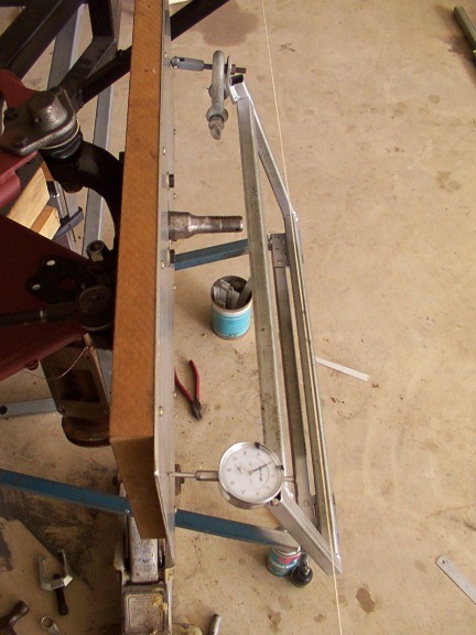

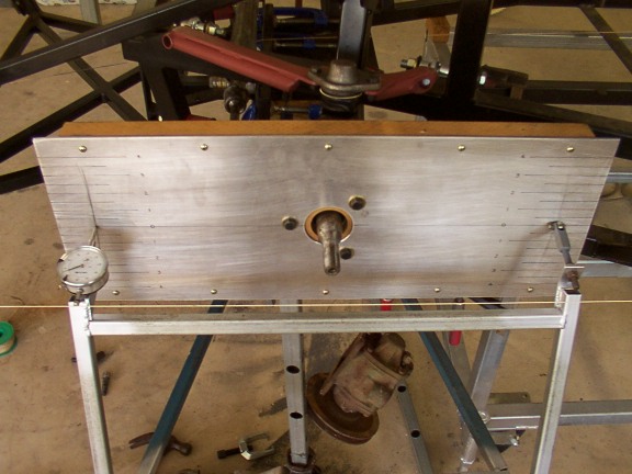

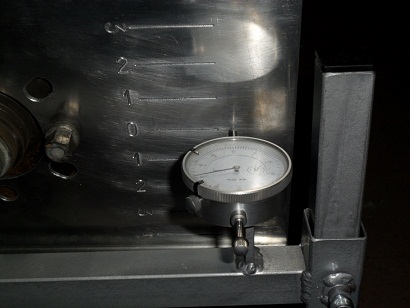

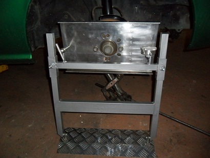

Normally bump steer is checked with the simple and reliable style of apparatus shown in the photo. As the suspension travels the dial indicator gives a read out that corresponds directly to the change in wheel steer angle.
The rack must be centered and locked, preferably after the car has been carefully centerlined and you are certain the LCA inner points and the rack inner pivots are, respectively, the same distance from center. The ride height needs to be established by measuring from the wheel center to the arch. The stabiliser bar (not fitted; why?) disconnected, the springs removed and the car level on 4 stands or a hoist. I use a scissor jack under the outer BJ and a long handle to set the checking heights
When a curve or line has been established over the available travel the outer tie rod is removed and a rod end (usually 1/2" unf is suitable) and bolt with appropriate rack adaptor (not shown for an Escort) angularity spacers and distance pieces are fitted. Start with the rod end set at the same height as the original tapered pin TRE. By spacing and checking you will quickly see the effect of a changed pivot location. The process is obvious and the bump toe out is the more important to get neutral.
If your LCA have been adjusted and are markedly longer than standard, or the inner LCA pivot has been shifted you may not be able to get things ideal. In the straight ahead position the LCA and inner rack pivots should be co- linear. This provides a reliable starting point and may require rack extensions.

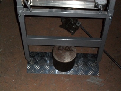

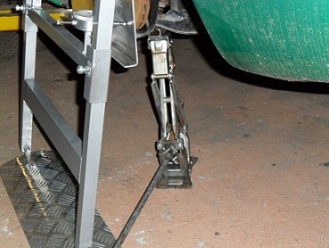

Bump steer 005.JPG (120.44 KiB) Viewed 17252 times
Bump steer 006.JPG (114.31 KiB) Viewed 17252 times
Bump steer 003.JPG (111.81 KiB) Viewed 17252 times
Bump steer 001.JPG (117.35 KiB) Viewed 17252 times

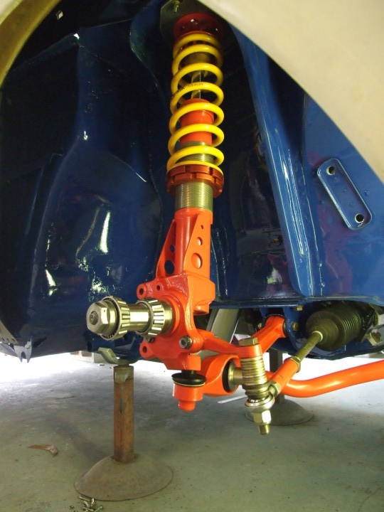

Used a similar Gauge to set up the Escort front end. The picture shows a whole stack of washers between the steering arm and rod end. These were added and subtracted until I got the best curve possible. Machined up a solid spacer afterwards. Couldn't get it spot on as the inner LCA pivot was moved outwards as per IP rules. Hence the rack pivot and inner LCA pivot aren't lined up anymore. The other pics are of the gauge fitted to another car. Couldn't find ones with it on the Escort.

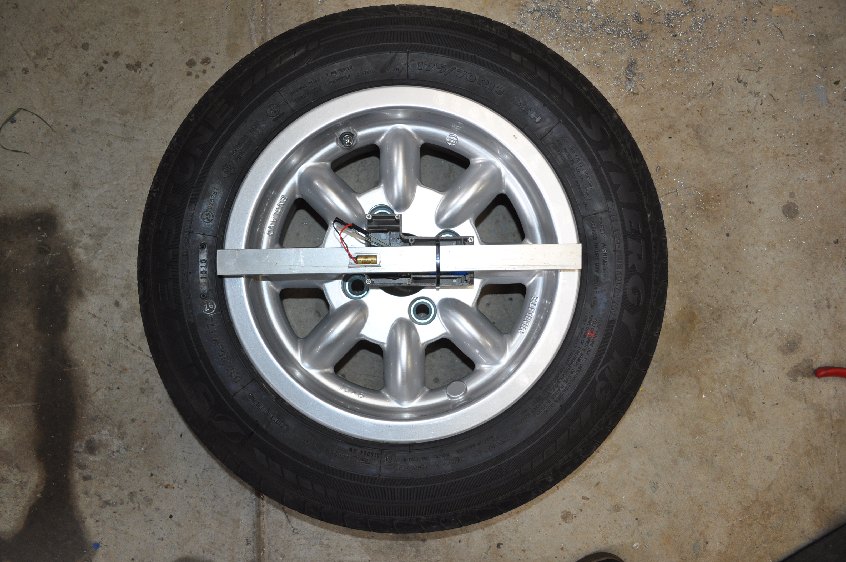

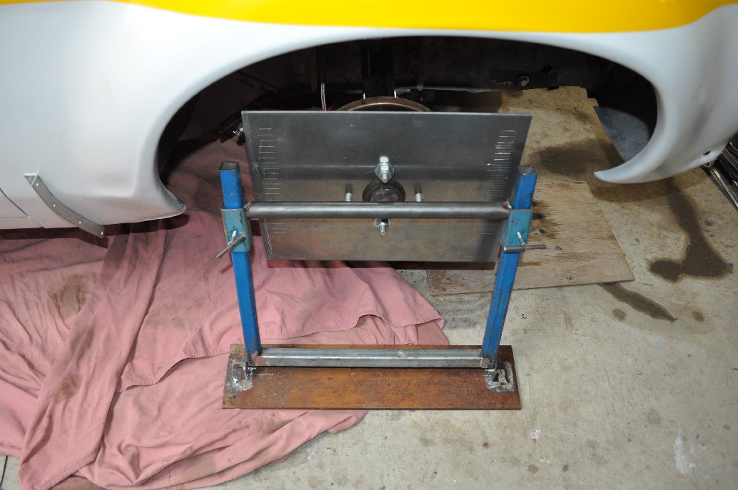

Sorry for the late reply, Ive been busy. I will try to explain how i come up with the graph i gave in an earlier post. In the picture below there is a laser attached to the wheel by zip ties. This is set up as per you aluminium plate attached to the hub with all other factors set. The piece of paper that the laser will be pointing at will be what ever number of wheel diameters you make it, 3 4 5 doesn't matter. Set the centre of the cross on the paper at ride height, rotate the wheel slightly to make sure the laser matches the vertical graph line, reset to centre and lock brakes. As you move the suspension through compression and rebound make marks on the paper at what ever intervals you like. All these marks on the paper now become right angles, and because we know all the measurements of this angle we can work out what the actual difference is at the wheel Rim giving you a +/- graph. I hope ime right cause at least it sounds good. As for no sway bar, why not. On bitumen with slicks absolutely on dirt mabe not??. I do have a 16mm drop link sway bar in the store thou. A couple of the pictures and this " When a curve or line has been established over the available travel the outer tie rod is removed and a rod end (usually 1/2" unf is suitable) and bolt with appropriate rack adaptor (not shown for an Escort) angularity spacers and distance pieces are fitted. Start with the rod end set at the same height as the original tapered pin TRE. By spacing and checking you will quickly see the effect of a changed pivot location. The process is obvious and the bump toe out is the more important to get neutral." have helped heaps. I got bored yesterday so decided to make a version of the gauge in the pics, i had all the parts and will get a dial gauge from work tomorrow to do the last couple of mounts . Will be interesting to see what sort of graph comes from this method.
That guage design is my commercial ($200) one and works well.
You don't even need a dial guage. Make it with a second set screw instead of the clock. If you set both screws touching at ride height, as the wheel plate travels a gap will appear under one of the screws. Measure this using the screw pitch, say it is 1.5 mm if you are using a M10 bolt or all thread; 1/2 a turn at 10 mm travel is .75 mm or 030" and so on.
