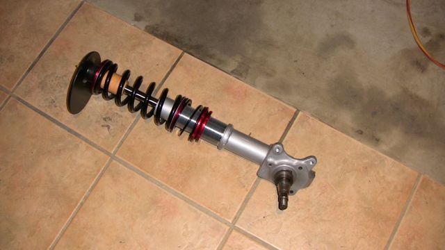

These are Capri Struts with double-adjustable Konis. 40mm had to be cut out of the strut length to fit the shocks. Tarmac use only, 275lb springs, works quite well.
