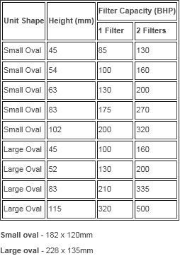

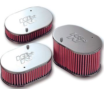

I am about to order some new filters to replace the socks on my webers.
Im using a redline manifold if it matters
What sizes are other people using?
dcoe filter.JPG (25.32 KiB) Viewed 3793 times
filter sizes.JPG (30.32 KiB) Viewed 3793 times

If you're using a standard cross member you want the small oval 83mm filters and you'll need a set of ram tubes no taller than 40mm and if you're using a world cup cross member you'll fit the 100mm filter and and tall than say 50-55mm tubes
